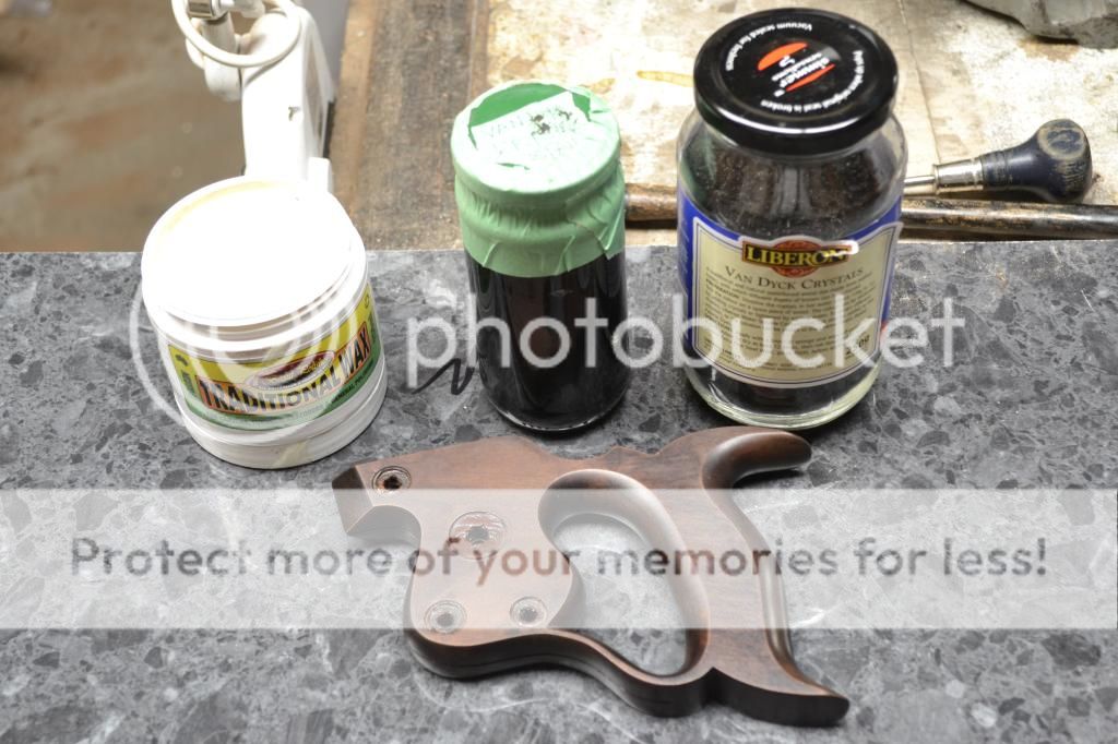

The 1st job was to remove the ugly finish that the previous owner had hastily applied. Its rather bulky original handle shape was typical of its circa. I felt the need to include some reshaping to improve its general appearance.

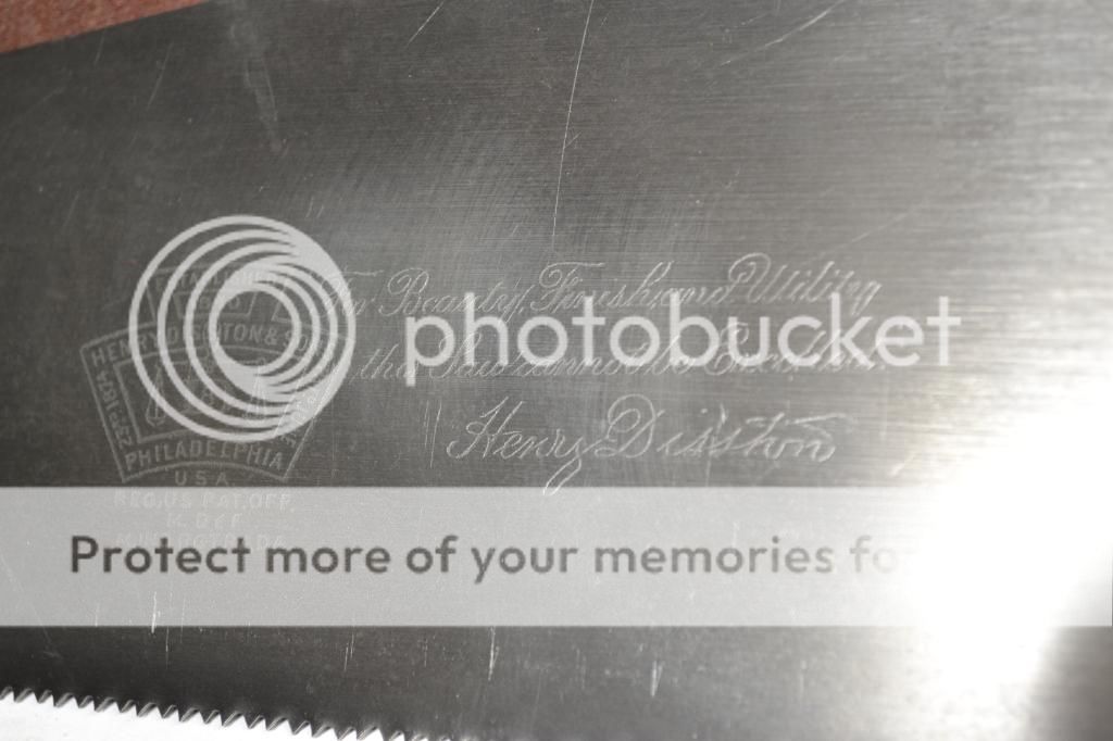

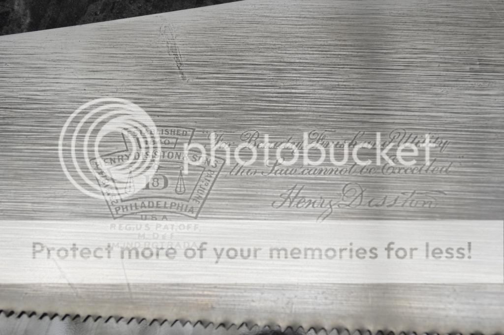

Next thing to do was darken the etching so it stood out more clearly.
[URL=http://s1009.photobucket.com/user/swagman001/media/D8%20refurbishment/_DSC0459_zpsxphogu9z.jpg.html][/URL]
vorher
[URL=http://s1009.photobucket.com/user/swagman001/media/D8%20refurbishment/_DSC0456_zpsu1k1avnt.jpg.html][/URL]
danach
[URL=http://s1009.photobucket.com/user/swagman001/media/D8%20refurbishment/_DSC0458_zps5rdqhud2.jpg.html][/URL]
With the hyphenated etching, I was able to determine the age of the saw as being post 1928. The H Disston & Sons medallion that's has been fitted to the saw is clearly not original, as its use stopped in 1917. Not of great concern.
http://www.disstonianinstitute.com/etch.html

I would appreciate your thoughts to the changes I made to the saw handle's shape.

Re: D8 panel saw refurbishment.
Hi Stewie,
you did a fine job by refining this handle. I like the colour and I like even more the crispy shaping you created. The lines are flowing in a very eye pleasing way. Great work. I guess that the handle isn't an original Disston one. It looks like it was shop made because of the very uncommon position of the lower saw screws and the fact that the screw heads are prodruding a little bit. Disston never made a handle with screws that close to the bottom line of the cheeks as far as I know. Nevertheless you've created a beauty!
Stewie, feine Arbeit an diesem Griff. Ich mag die Farbe und die klaren Konturen. Allerdings glaube ich, dass der Griff nicht original Disston ist, weil die Position der Schrauben ebenso ungewöhnlich ist wie das Hervorstehen der Schraubenköpfe. Disston machte meines Wissens keine Griffe mit derart weit unten positionierten Schrauben. Nichtsdestotrotz hast Du eine Schönheit daraus gemacht!

Hello Klaus. Thank you for your kind comments. It is my appraisal that this apple wood handle is an original to this Disston Saw. The reason I feel the saw bolts are not seating more flush looks likely the result of the previous owner too aggressively flat sanding the faces of the handle, thus reducing the depth of the saw bolt seats. Never the less. I am hopeful my work has adding some much needed charm and beauty to this panel saw. I very much enjoyed the challenge of doing this work. It allowed me to fully employ my ongoing understanding within good handle design, of which I owe much gratitude to yourself.
with regards; Stewie.

Update. I have gone back and reviewed the information within http://www.disstonianinstitute.com/etch.html. After 1928 the model no. would be etched as D - 8. This saw has the 8 etched inside the D. That translates to this saw being pre 1928, and the medallion is most likely correct for this saw.
regards Stewie

Hi all. This is the final presentation of the Disston D8 panel saw refurbishment.
The handle has had 3 coats of garnet shellac. Later buffed to a nice shine.
